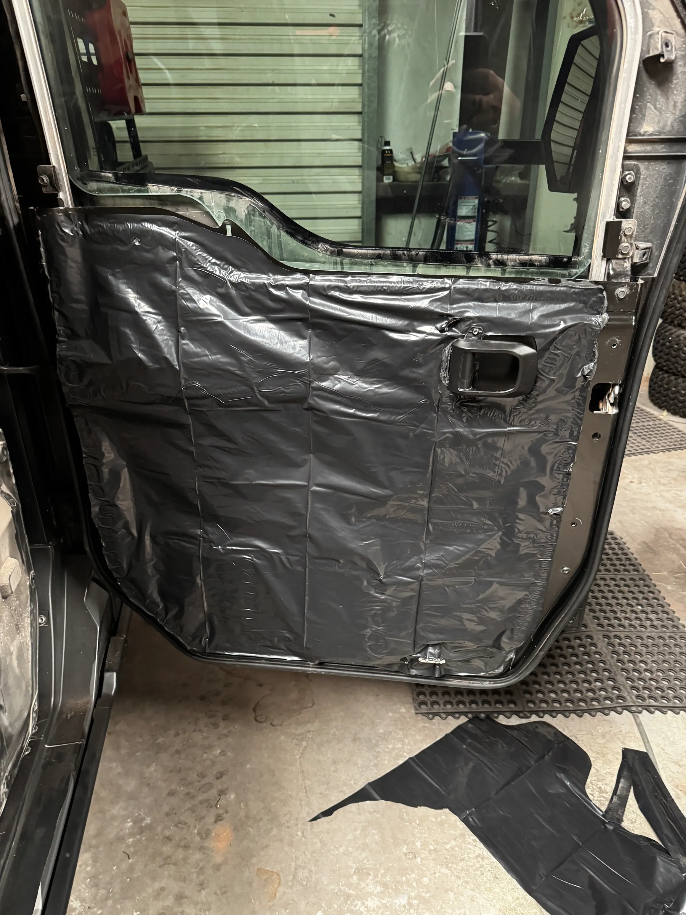

We had the dust problem on my Brother’s XD1500. I pulled all the interior panels off and behind them is a very open stamped metal frame with lots of big open areas.
My solution was to cut out a piece of heavy plastic sheet and silicone it over the metal frame. I also tucked a bit of foam around the door latch a that cut out nearly all the dust.
Sorry I didn’t take a picture before I put the plastic on. 🤷‍♂️

I did manage to find a picture of the door before the plastic was installed…
So you can see how did the lines of silicone on the door frame. Then I just layed the plastic over it and pressed it onto the silicone.
