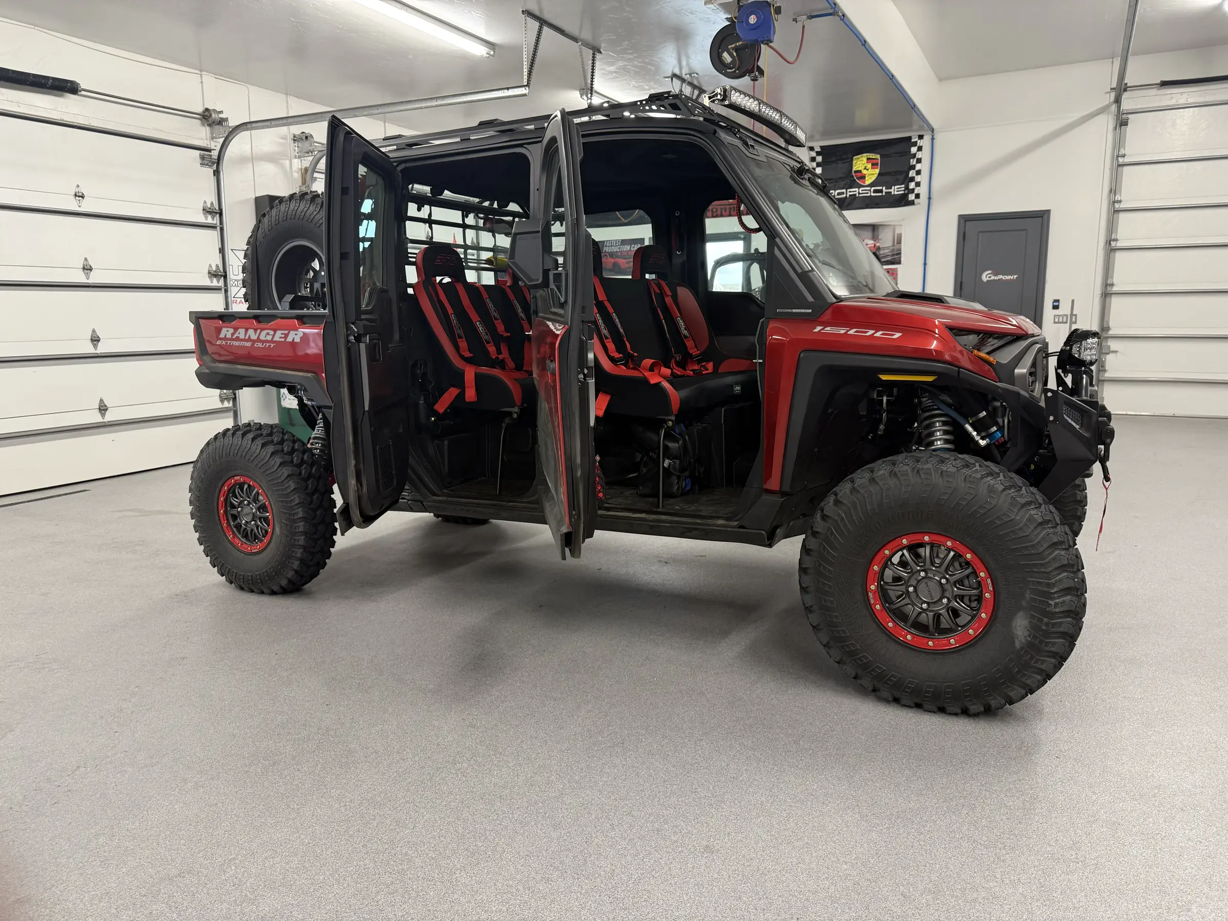

So we used Thumper A arms but ended up building shocks with King. The Fox QS3 is a good product just didn't do what we were trying to achieve. Shock Therapy is owned by Fox Shocks and worked with Thumper Fab to design the QS3 to work with there long arm for the Ranger 1500. It works well, they also offer a one to one replacement for the stock shock if you don't want to replace a arms. if you're looking for an up grade from Stock thats the way to go. They will give you a better ride and off road ability over stock. The fox QS3 for the Ranger 1500 from Shock Therapy is a single rate, without bypass and have 3 compression settings. In most applications this will work OK. We wanted a dual Rate spring set up with Internal bypass. So we could dial in Valving, Compression and Rebound. We did all the math in our shop worked with King Shocks to build the shocks and used Eiback to dial in the springs rate. We went through 10 sets of springs for the dual rate to work properly and achieve correct ride hight without being to stiff. If any one wants to take there Ranger to this level we can share details on our build. Here's a few Pictures.

Very nice. I knew someone would dive into some advanced suspension. Did you by any chance do any mods to address the noisy sway bar connections ?
We used heim joint connectors from Shock Therapy stock sway bars with 4ply PRP limiting Straps and cobra axels. This eliminated all the radials.
would you happen to have the specs for your king shock setup or who did the work on them?
First of all, I want to say we do not work for any of the companies I’m talking about below. We are a pro race team and have a in house fab shop for our race team only. We built our Ranger 1500 as a pre-runner for our own use, we were looking for Something that can go across the whoops in the desert at 50-60MPH and have AC Haha. The best way to look at the suspension on the 1500 is at four levels.
Stock, Polaris did a nice job on the ranger 1500 suspension works ok as you can all see but is limited. Depending on your needs this will work all around but not great.
if you want to improve Stock without much work the fox Series 2.0 Podium QS3 shock kit is a good option. Shock Therapy valued and spring the QS3 for the Ranger 1500. They are owed by Fox and have a great R&D shock team, they did I nice job The QS3 fox shock is a single spring no bypass with 3 compression settings. For a one to one replacement bolt on shock using stock A arms. under $3K This is the way to go.
if you need a little more clearance (19In + at ride height) I like the Thumper long arm kit they are boxed and tig welded, Thumper worked with Shock Therapy to design a fox QS3 shock for their kit as well. They extend the shock about 3 in and are using the upper outside shock holes on the ranger. it’s a direct bolt on fit no modes needed. Also using the King Cobra extended 300M axels will help with some of the stock axel issues. Unfortunately, this Kit is north of $10K complete.
What we did! We wanted a internal bypass shock with crossover rings so we could have the first 2 inches of travel soft and then and then primary spring goes to work. This is the same concept we us on a trophy truck. With a short shock travel of only 7.5in this was a challenge. We ended up using a 2.5 internal bypass King Shock housing. #25700-327A with external reservoir. The internal valving for Rebound and Compression was crucial. All springs are Eibach springs. Front spring set 6in-3.0 600lb upper/ 12in 3.0 700 lower with 1.5in pre-load. Rear spring set 6in-3.0 700lb upper/ 12in 3.0 700lb lower 2in pre-load. The Cross over rings are set at ¾ in front and rear at ride height. With lots of test and tuning to achieve 19in of ride height and operate the way we wanted this is what we ended up with. This unit will keep up with our Pro R RZR wide open across the desert. The last thing we did was weld in tabs for limiting straps so were not depending on the shock to bottom out when ranger is in the air. If your interested in these all in their about $5K and King has all the shock specs. You have to us the Thumper A arms as well. Call King Race division tell them you’re looking for what they did for OnPoint Racing’s Ranger 1500. King dose not have the spring sizes we used so you will need to order them from Eiback and build the shocks.
