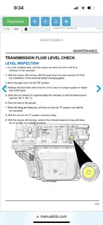

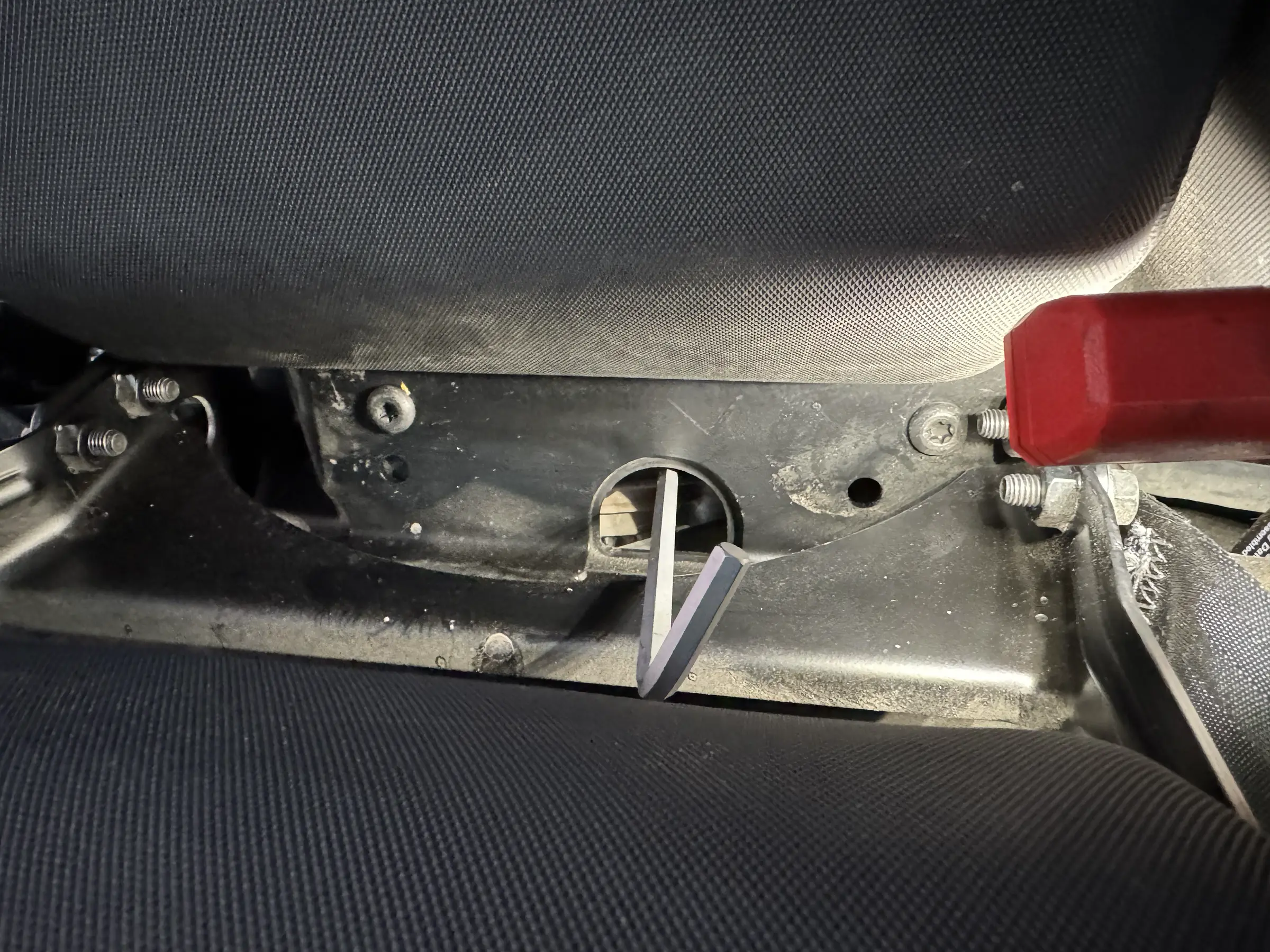

Fill Port on the Transmission
My Polaris dealer (Dillon MT) printed this page out of the service manual (available for 90 bucks) which was helpful to me, also figured out there is a rubber grommet under the center flip up arm rest in the back seat, (crew cab) to get access to the fill port.
