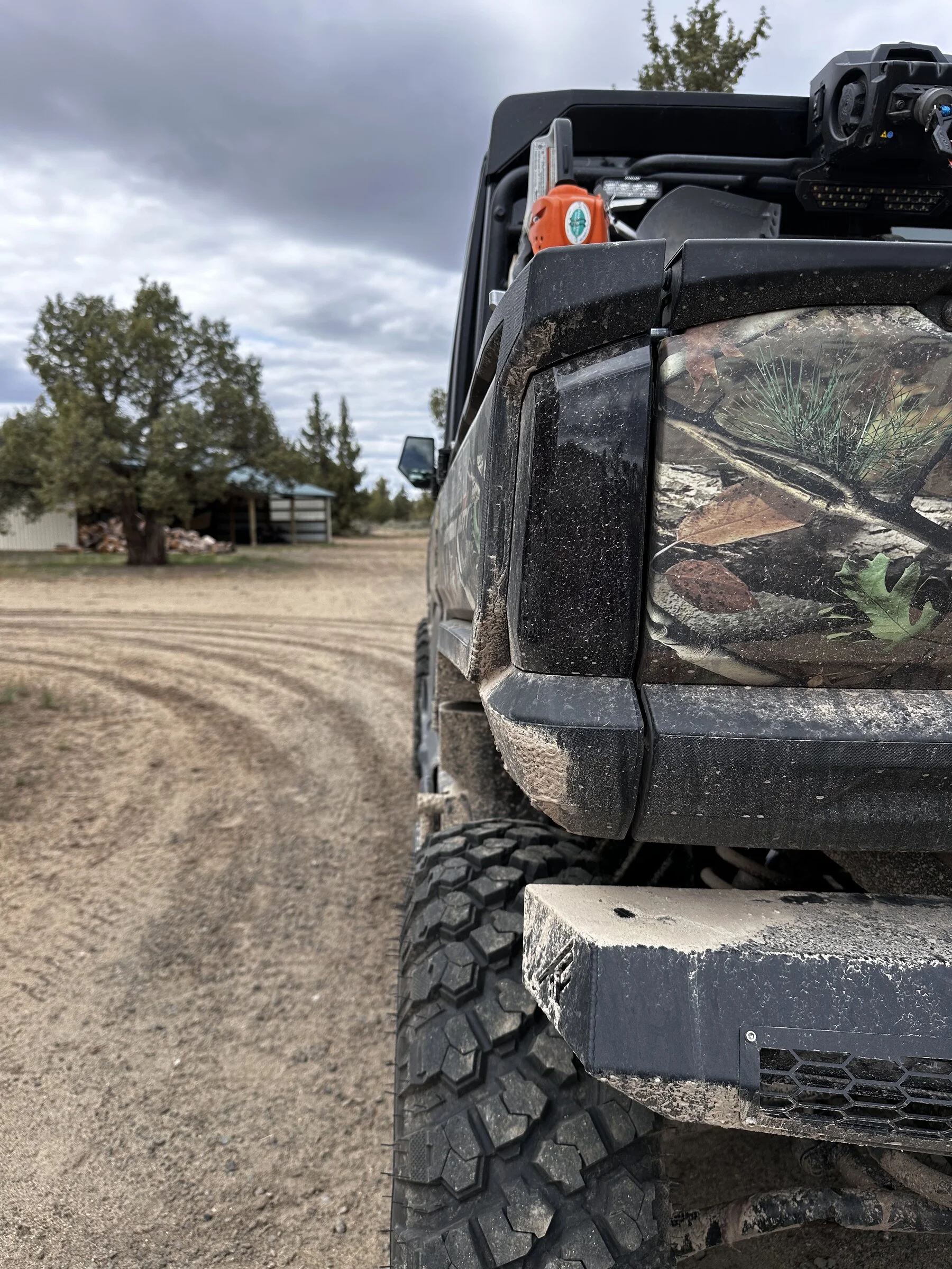

I attached a pic of the valor set up, wheels and tires. I like the looks of my tires sticking out just a bit, so for me it’s the perfect look. You can use the factory wheels if you want. Same exact size on all 4 corners (15x7) same as the valors. With the valors you will stick out a little wider, but not much. You can see in my pic. I don’t think it’s much gain to go to a 33” in my opinion. Can’t help much with the ADC or rifle mount question. I do know I’ve gone down some steep muddy/gravel stuff, and in 4WD/tow haul mode, I was fine.

2-3. If you don't want the machine wider and you really only have about 1.5" on each side to get through a gate don't buy any rim different than a 6/1 same as the stock rim. Yes, the XD rims are the same on all four corners. The XD is supposed to be the same width as the XP so you won't want a rim with a different offset. My rims pushed each corner out 2.11" which made it 4.22" wider! Use the stock rims with 32" Alpha's and you should be happy.
