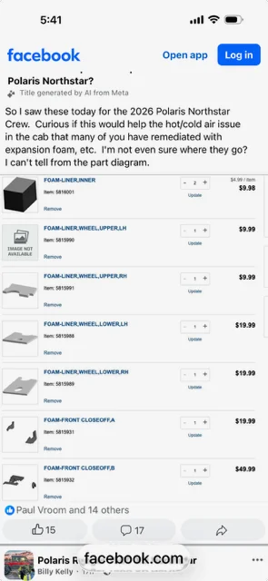

Go to body parts listing it is the inner dash panel called the closeoff
25 has no foam listing 26 does looks like they added 10 pieces.

So basically what I would call the firewall…. I found for the 25… can you share where you found the info on the 2026 models.. thx
I just found it on the polaris website and selected a 26
and found the parts listing

I think the new pieces are on the outside under the fenders and some look like plugs , maybe to fill holes some have been filling with foam . I think there are ten pieces.
I took the fenders off of ours and spray insulated all the holes and taped some places to make it look factory.
I thought about ordering the pieces , currently says all are on back order . Mine seems very good around dash area , no cold air. I get a little around drivers door handle at times . I thought it might help insulate the radiator heat on 90 degree days . All in all mine has been really good , I did add some weather stripping in the gaps between inner and outer door panels .

I found this on the web. It appears my 2025 has these already installed?

When I got the machine home, I pulled both front fender assemblies off and spray insulated all of the openings then put black gorilla tape over them. I pulled the front corner windshield area speakers and put foam blockers and sealed everywhere so no air come through the speakers also. I used foam at the front door latches to seal them when driving.
I pulled both tunnels and insulated them with pipe insulation then used pipe insulation on all the coolant pipes. Did a few other things also.
Before I did all of that mine was still a lot better than by two buddies 2024 1500 crews which did not have the above factory installed
insulation.
