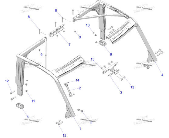

After looking at the diagrams, while yes it is a big job, it doesn't look horrible. Basically remove the headliner, roof, windshield, back glass, and any other trim pieces, and then it just bolts on. HOWEVER... it may be asking a lot from a local tech. There is a bracket that joins the right side to the left, secured with 4 bolts... I wonder if there is just enough movement here that if you loosened that bracket, you could adjust it enough to resolve the issue. Not sure. You'd think if that was possible, Polaris would suggest trying it. However, the dealer might be reluctant. 🤷‍♂️
