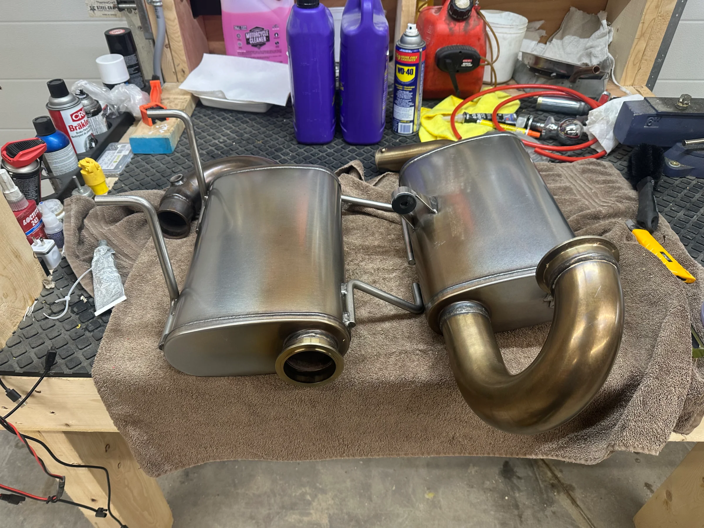

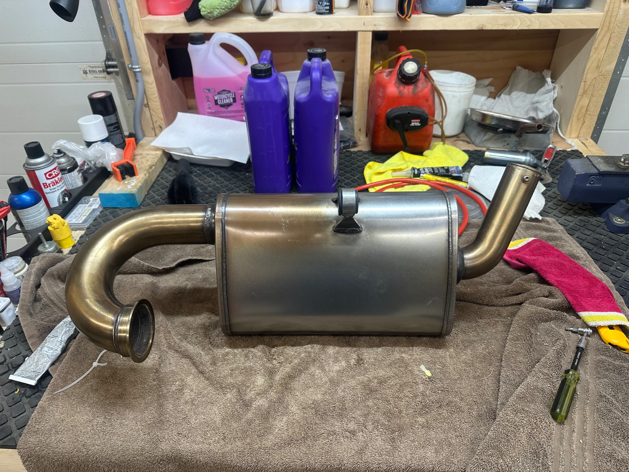

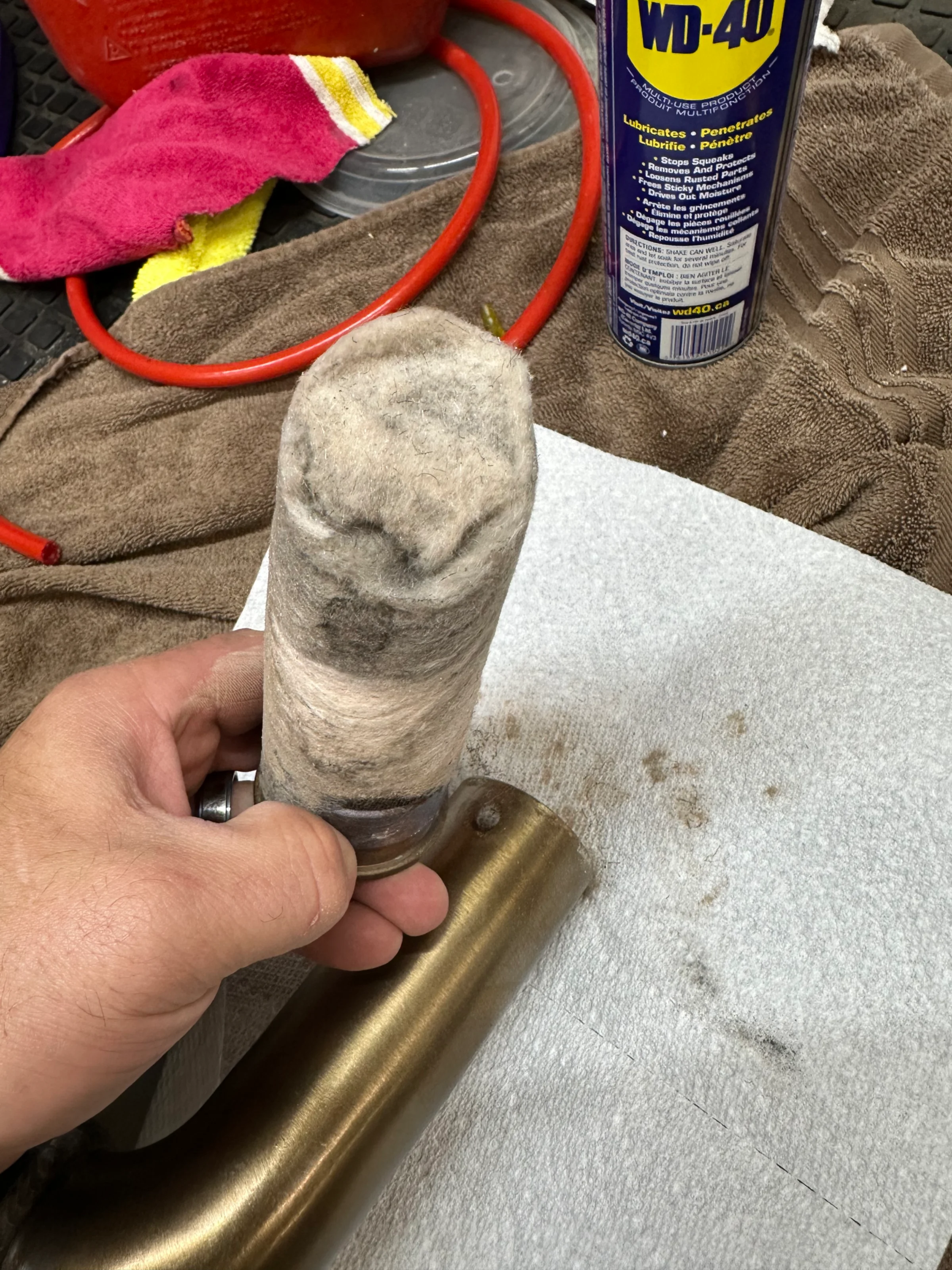

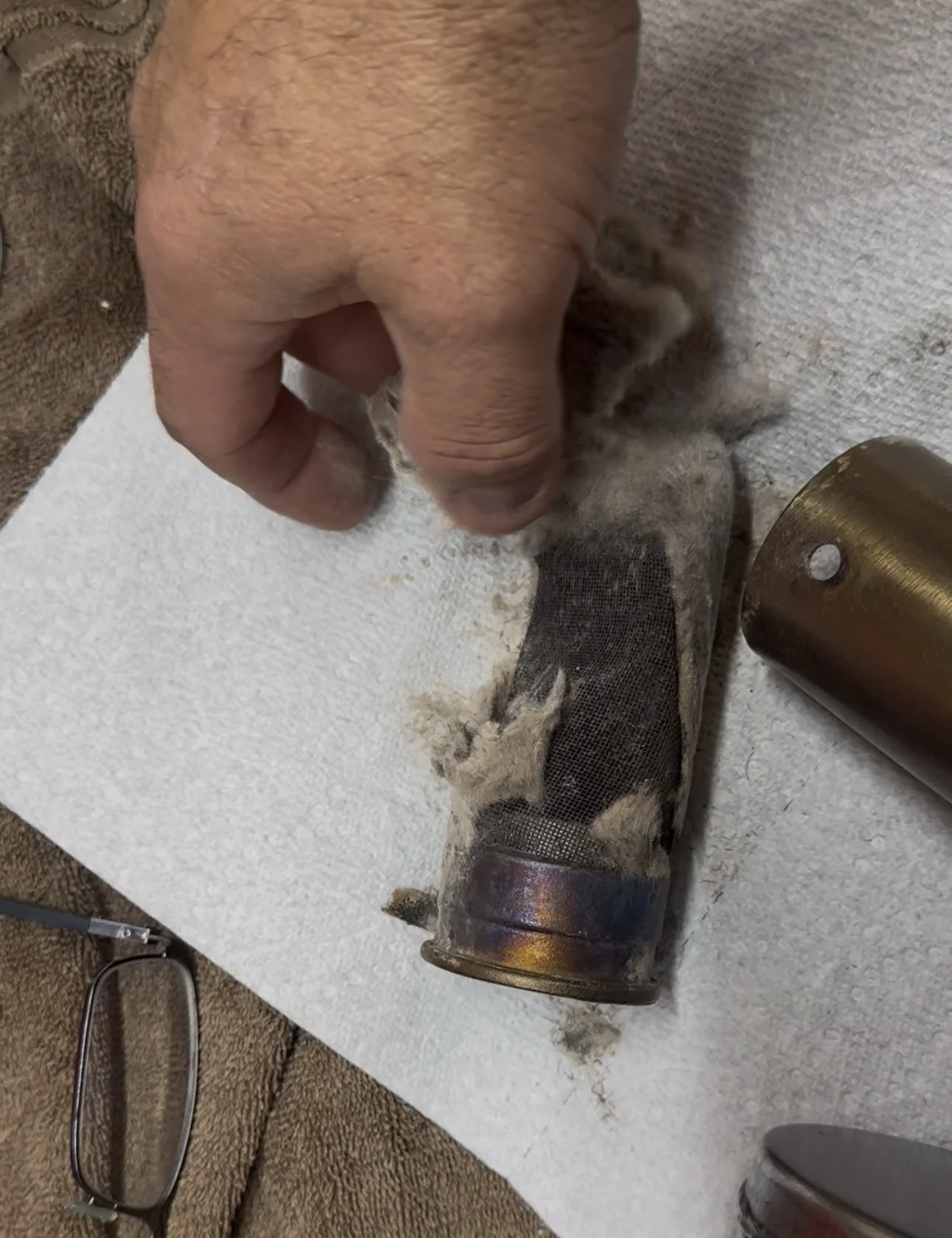

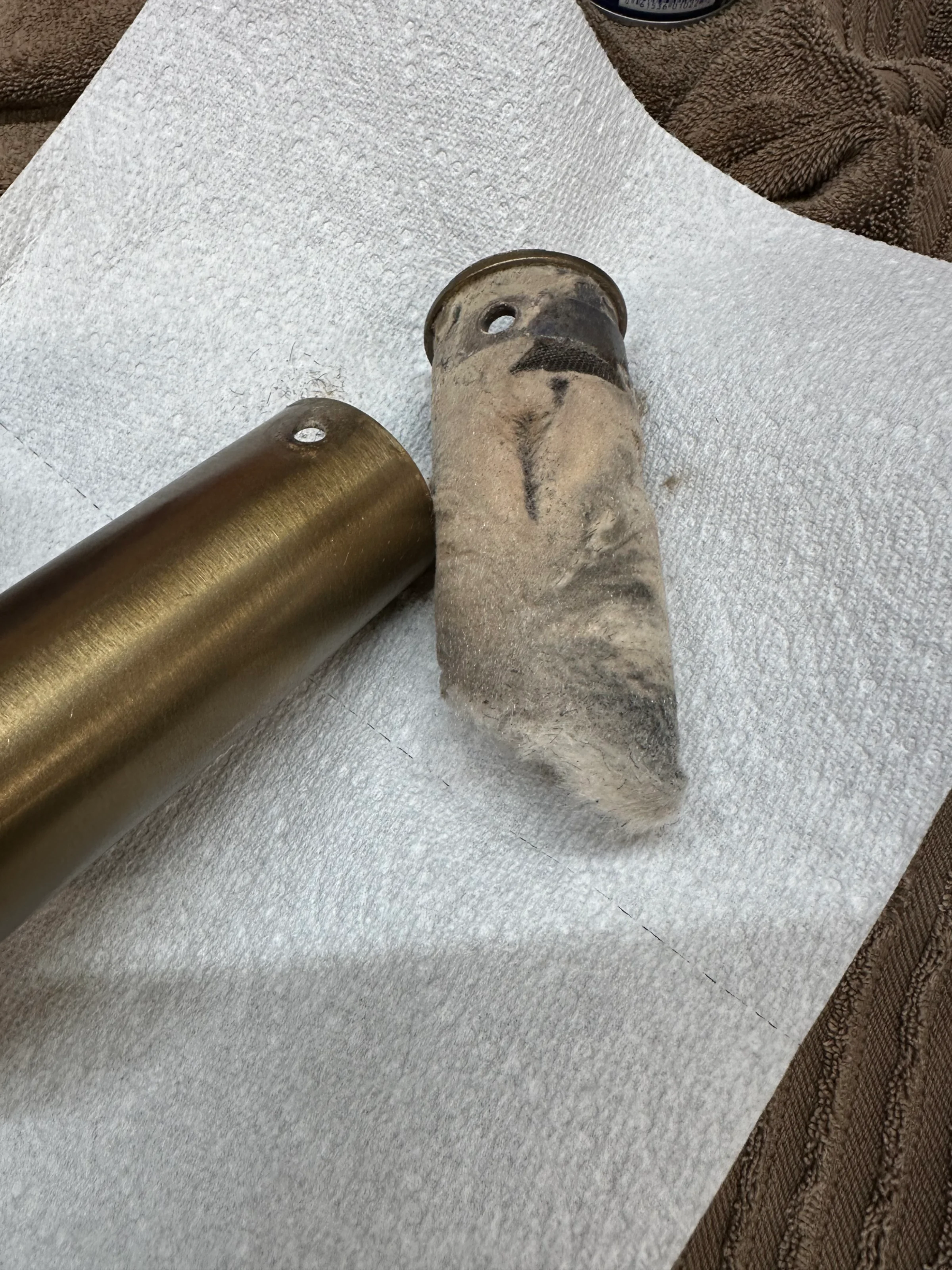

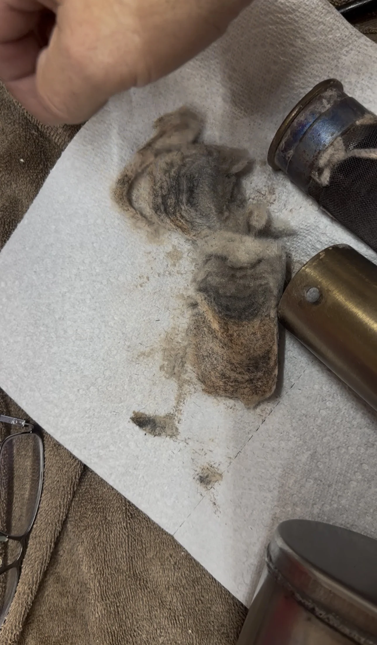

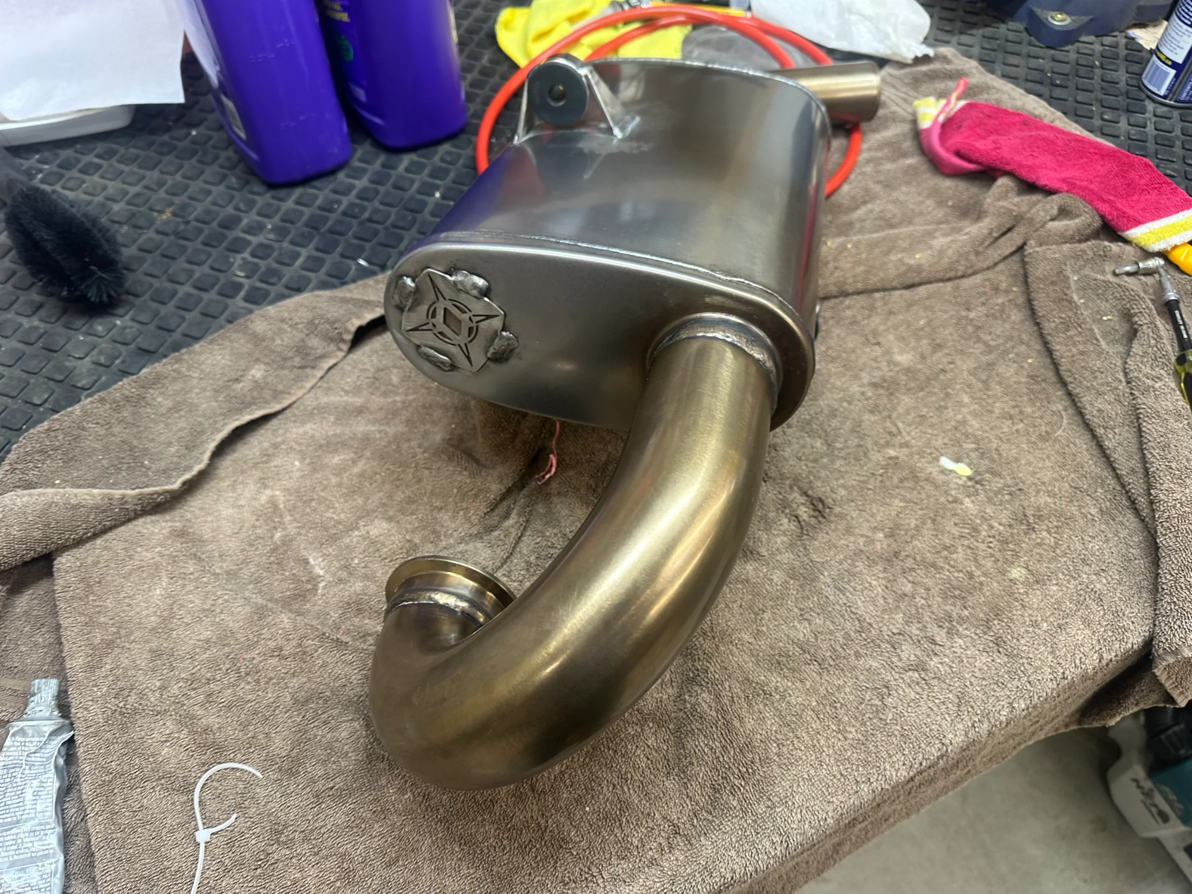

Was preparing the exhaust for sale. Checked the spark arrestor. First time there was some debris. Second time there was more I didn’t post a pic of that one. Third time here is a pic. They are sending me another second muffler.

Wow. That looks like a major failure. It will be good to hear from them whether that is a one off issue or the result of a terminal design flaw. I’m surprised they didn’t ask you to return it for an autopsy. Guessing they already know the answer. Not good….
Dam, I think I’ll hold off on any exhaust at the moment. Hopefully the second one doesn’t do the same.
Any one else running this and want to check their spark arrestor? View attachment 4939View attachment 4940View attachment 4941View attachment 4942View attachment 4943View attachment 4944View attachment 4945

They said this is first one ever. And they’ve sold “over 100 systems out there in 18 months” they are getting more made. They don’t have any stock left. I’m in Canada and shipping sucks back and forth. I have to pay to get the replacement exhaust here. Which I understand.
Being quiet at first was the packing was where it was supposed to be. Now obviously it’s not.
