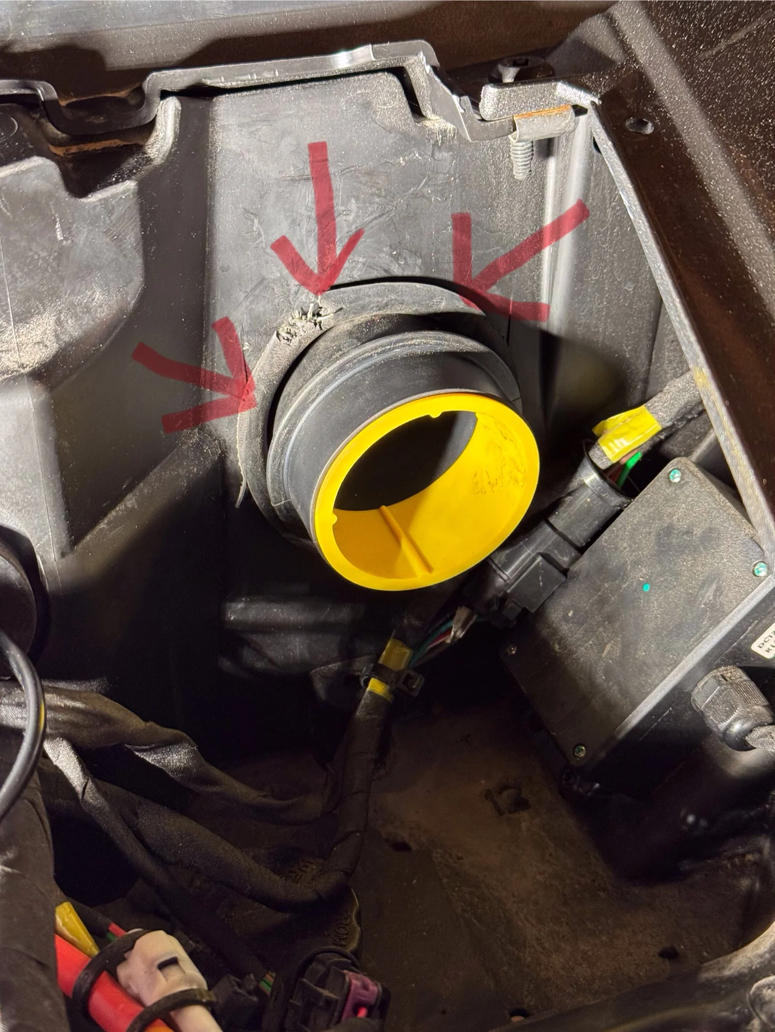

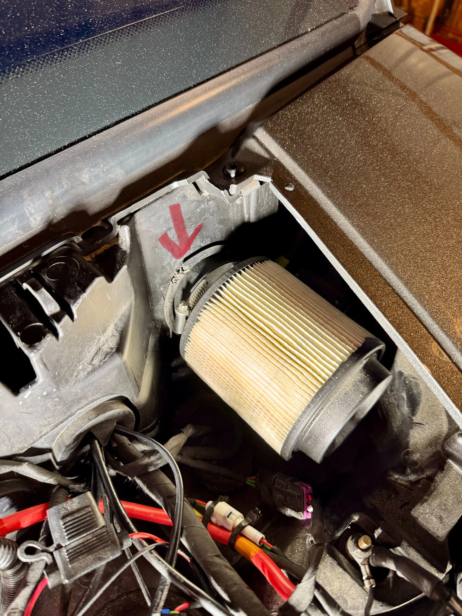

I believe a lot of the hot air is coming from the opening around the filter housing assembly. I would not remove or cover the filter. I just cut a piece of rubber tubing lengthwise and slid it on the opening behind the filter which seals up the opening to the filter housing. I removed the filter only to get easier access to behind the filter. If I get a chance later this morning I will try to get pictures to show what I did.

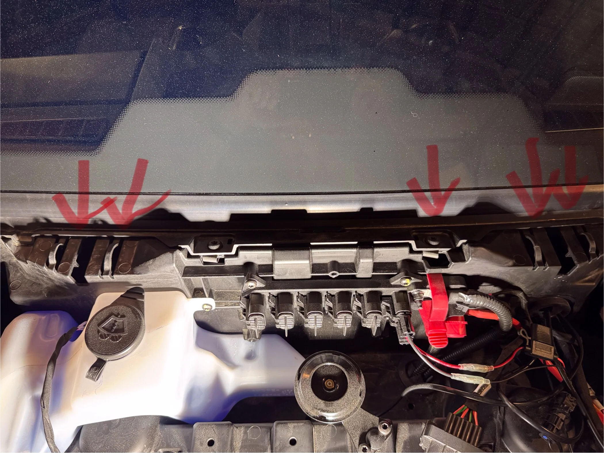

First photo is filter in place, red arrow is piece of tubing I slit lengthwise and slid in place. You can see damage I did to tubing with needle nose pliers 😂. Second photo is with filter removed to help see opening and where tubing helps seal the opening. This opening is in line with steering column. Third photo shows openings in piece on firewall. I think some are covering them. They line up with vents on hood. I have no idea why they are there but assume they were engineered for some reason. Hope this helps explain some of this.

Those other openings in your third pic is where the hood latches latch to. I'm sure there is a lot of hot air coming in there but I don't see a way to seal it up.
Now that makes perfect sense to me. I have some self adhesive foam that I think I will butt up against the firewall and wrap around the tube. That should block the opening and prevent the hot air from leaking in. Thanks for the pics!

I didn't have any hose laying around so I sealed the opening around the filter tube with RTV silicone. I stuffed the openings where the hood latches with foam rubber. Seems to work well. Very little air and dust coming in now.

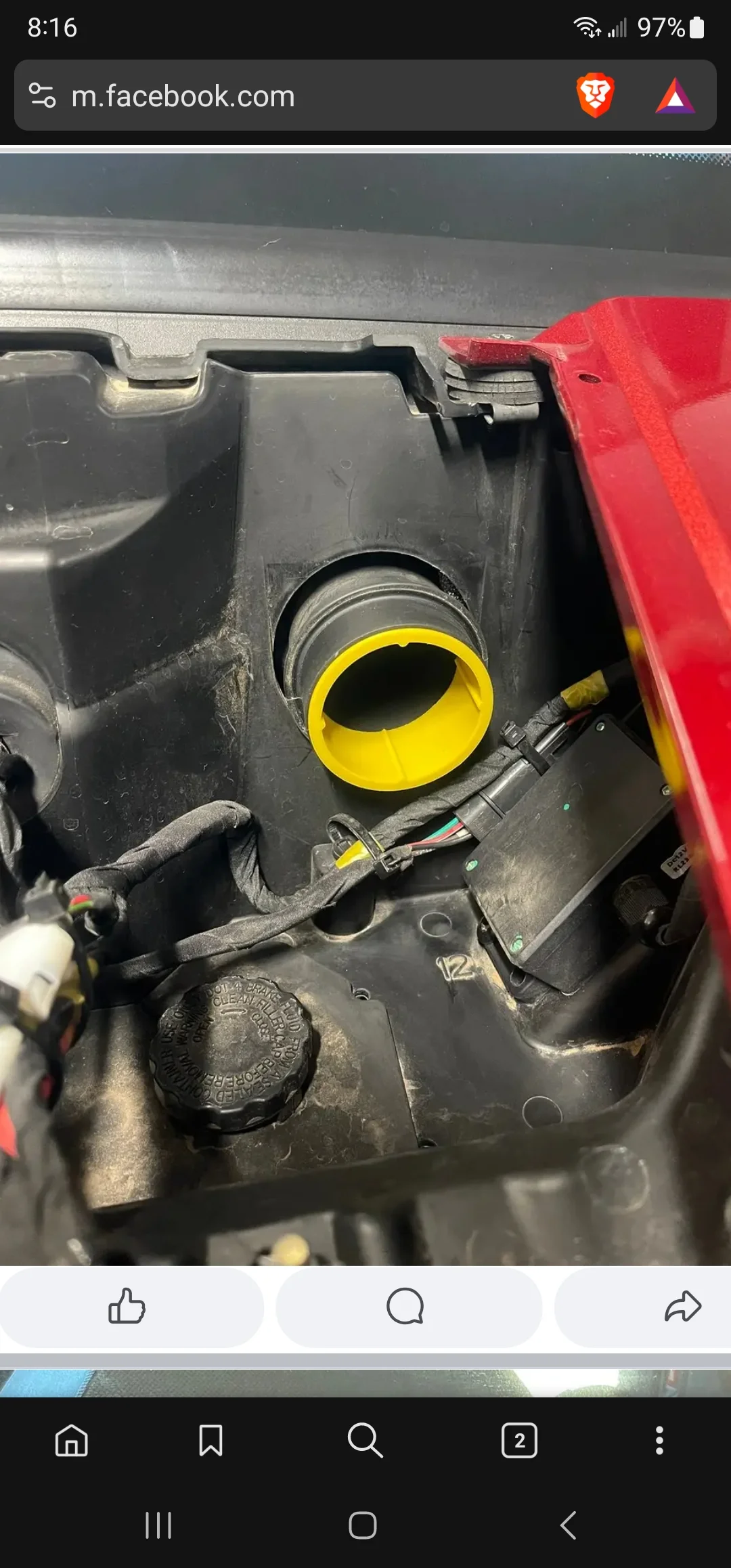

ETA: Was on an 85 mile ride today with the Nokomis ATV Club riding the Harrison Hills trails. Very dusty trails today. Had to use the wipers to clear the dust off the windshield occasionally. After sealing the cabin air filter tube where it comes thru the firewall it's amazing. We did have the AC on but we noticed NO other air or dust coming in anymore. I think we've finally got it. Very Happy! The attached pic is from a FB post. But it shows the opening in the firewall that needs to be sealed up. Made a HUGE difference for us. Hope that helps some of you.
