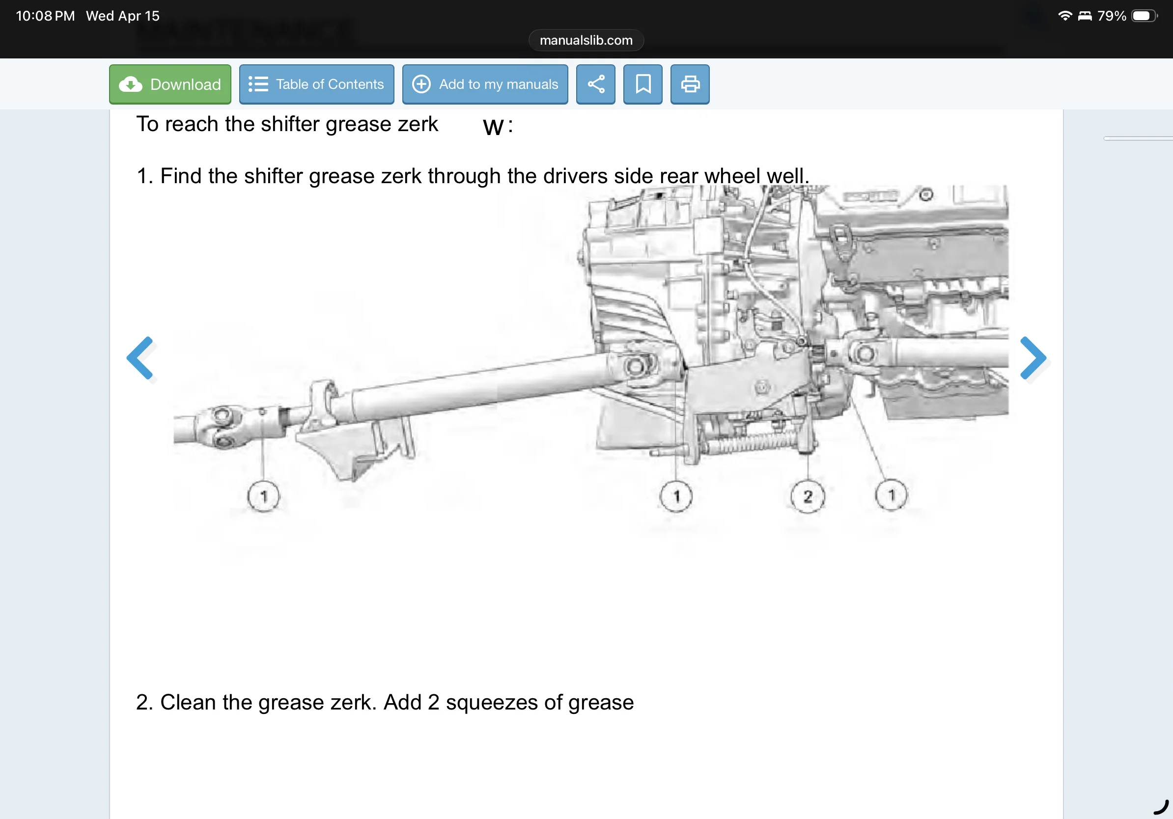

Could you please explain where you put the grease? I’m unclear there and I apologize for that thank you.
straight down from back of cab. There is a grease fitting on the out put shaft where the trans hooks to motor.

I think zerk 1 on the right side of this diagram is the one he’s referencing. I grease this good once a year and haven’t had the clunk at @2400 miles.

correct zerk 1
