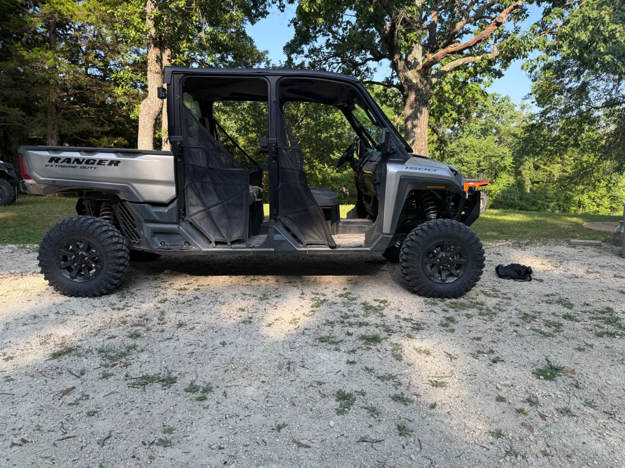

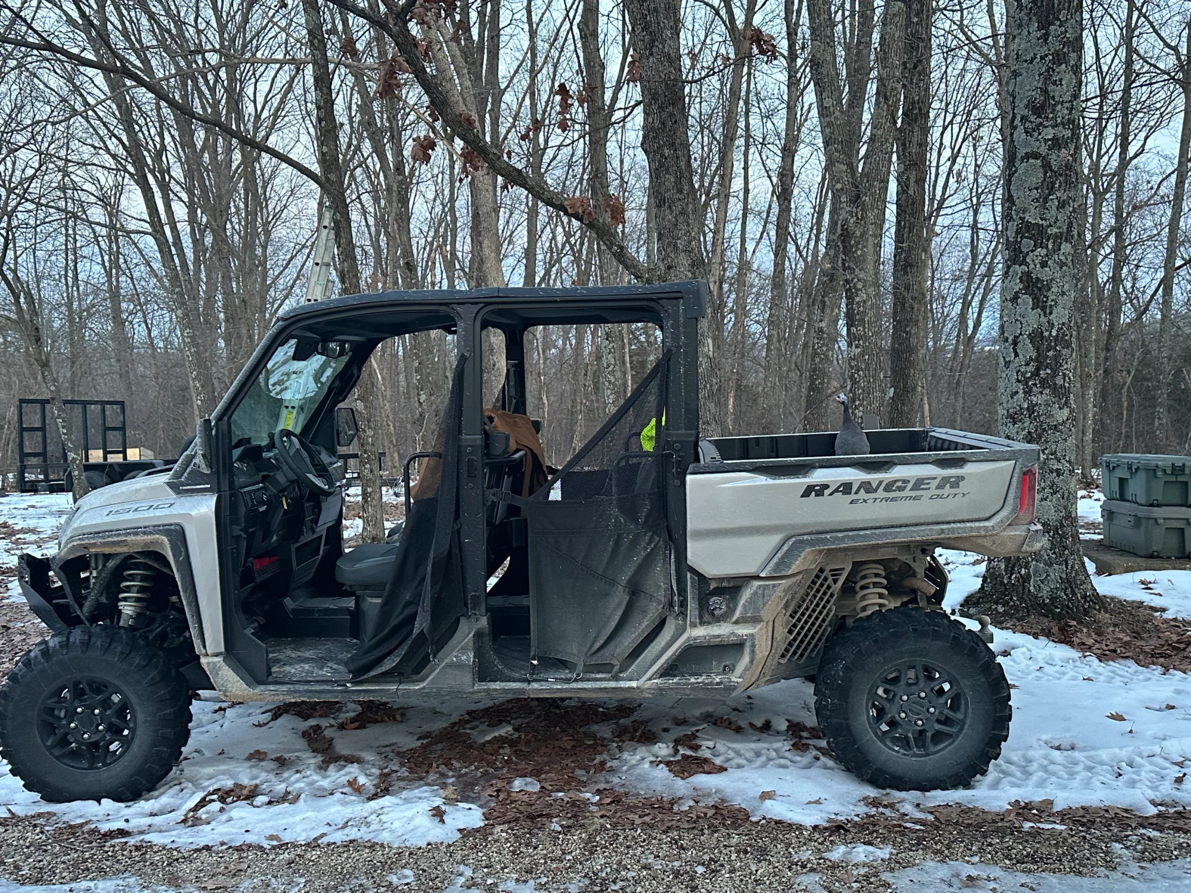

Nothing special but I attached pics. The one in the winter is the before pic.
Looks good and you bought them right. Plenty of free rubber left on them before you need new tires.
