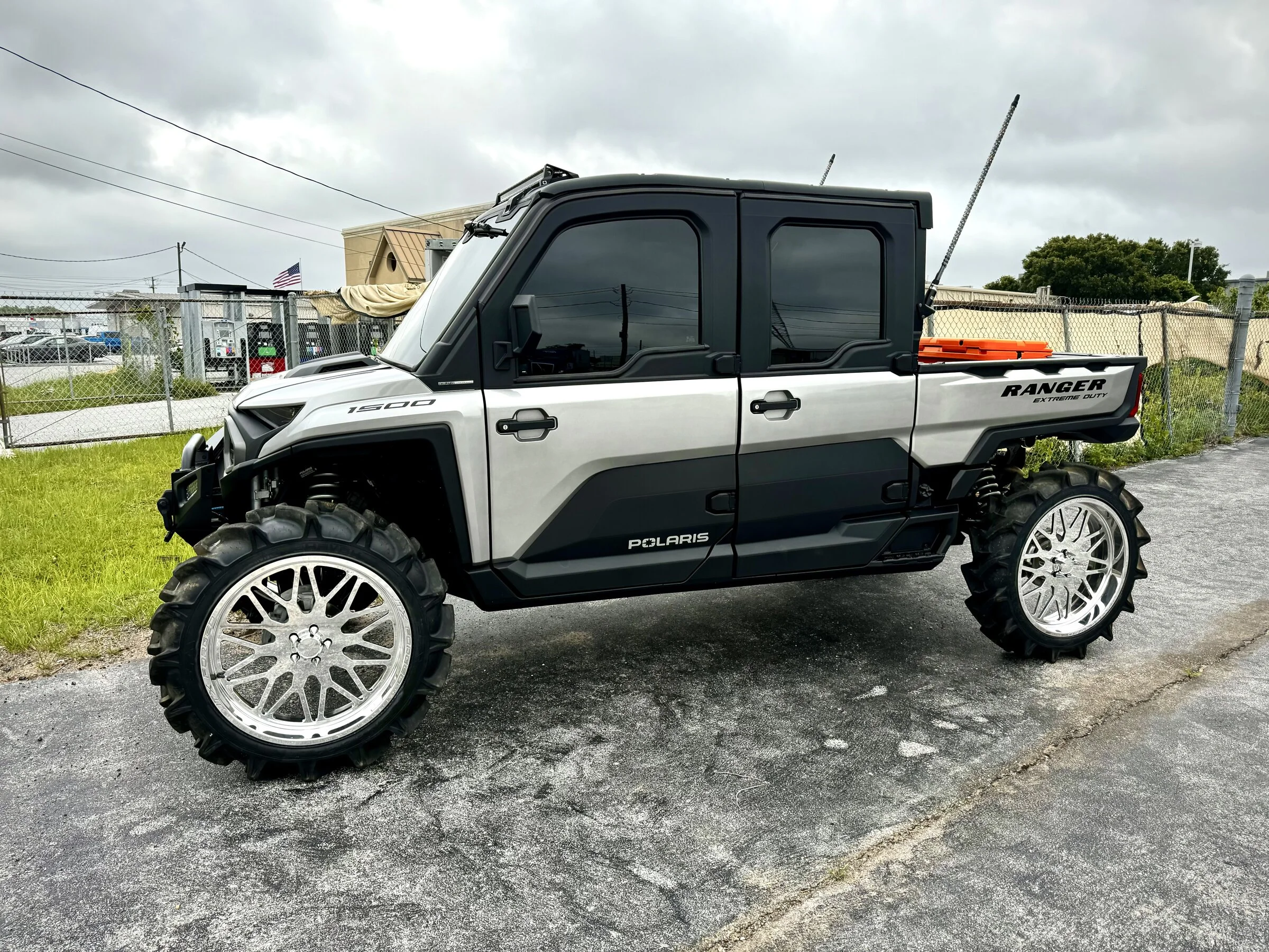

37” EFX Motohavoks on 24” JTX Forged Wheels. Running S3 Powersports +2” Forward Arms. No rub at full lock and compression surprisingly!

No sir, just picked it up today. It’ll be in the mud / swamps tomorrow though!
Cool, can't wait to hear how it performs! What did you have before the XD?
Holy Shit that's a lot of wheel and tire! Somebody is looking to take their shiny rig to a big mud hole. Looks great Kalon!
Man, you have to have first place for the most gnarly 1500 on the planet.
By the looks of the one in the background this is not your first merry go round.
BADA$$
