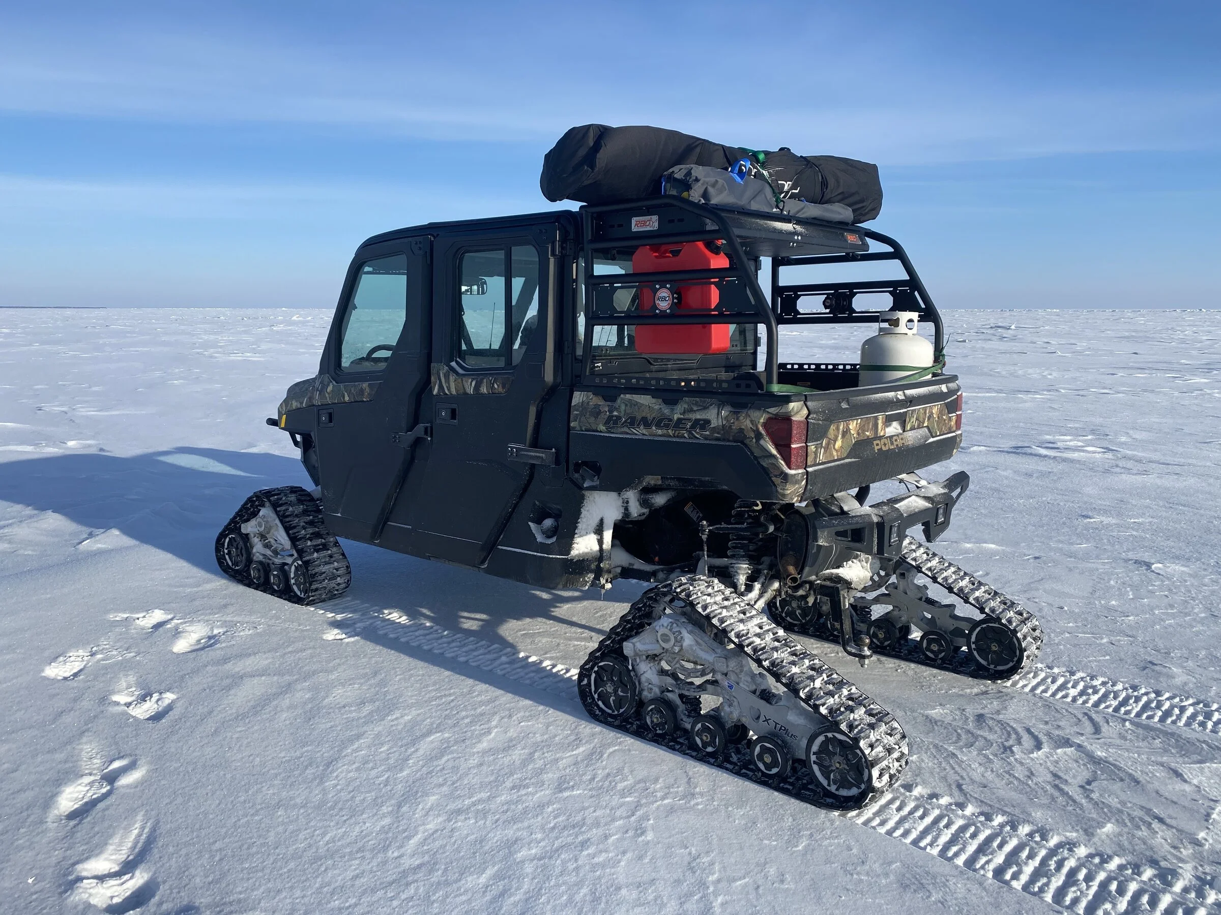

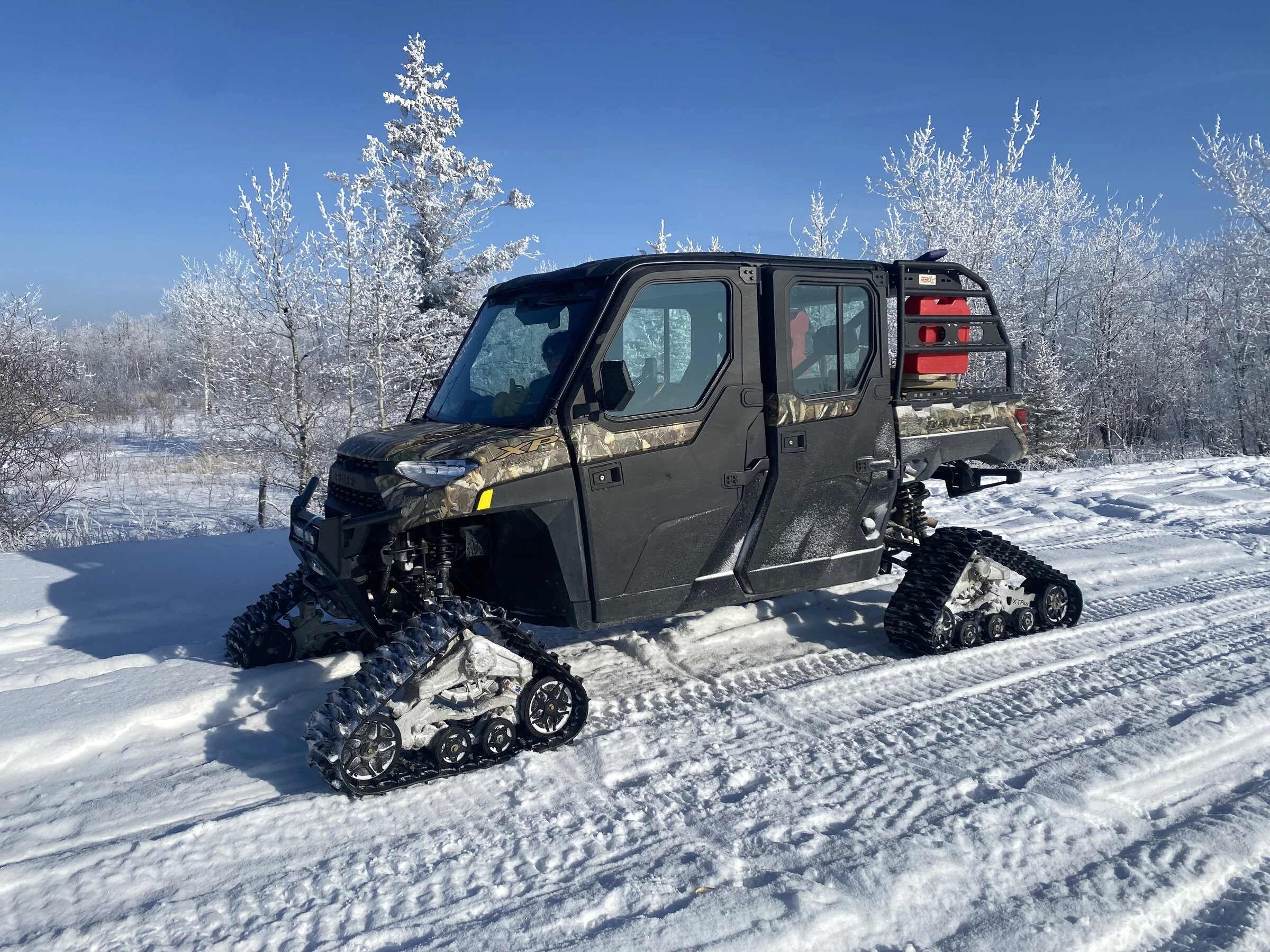

Hello all, new to forum. I just completed my installation of Duratracks. I agree with Adk above on the install. I did it alone in about 7hrs. Yes thats a long time but I had never installed tracks for the first time on a machine. Always initially installed at the dealer. I, too, will be using the rig for grooming and Ice Fishing. Rig probably weighs 3500 loaded with gear and two people, so need close to a foot of Ice to feel safe. I will post some more pics of it in action.
Took her out tonight for a Break-In. I put the magnesium in the tracks and took her on a paved road for about two miles. About 1/2 mile into it, I got an acrid rubber-burning smell. I stopped and inspected all four tracks, felt no hot spots, and kept going. I called Steve at SVI for advice when I returned to the house. He said that is normal. The Hi-Fax on the center rail must undergo several heat-up and cool-down cycles. I am glad I called because I almost decided to yank them off.
I look forward to taking the rig to Lake in two weeks. Just waiting for this custom Ice fishing box to come in. There is a big 3-day fishing derby at the end of the month.
