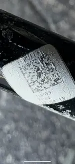

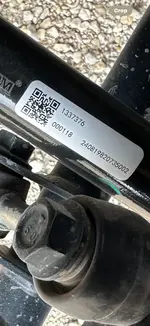

These are the most current axles. Is there a way you can check yours?
