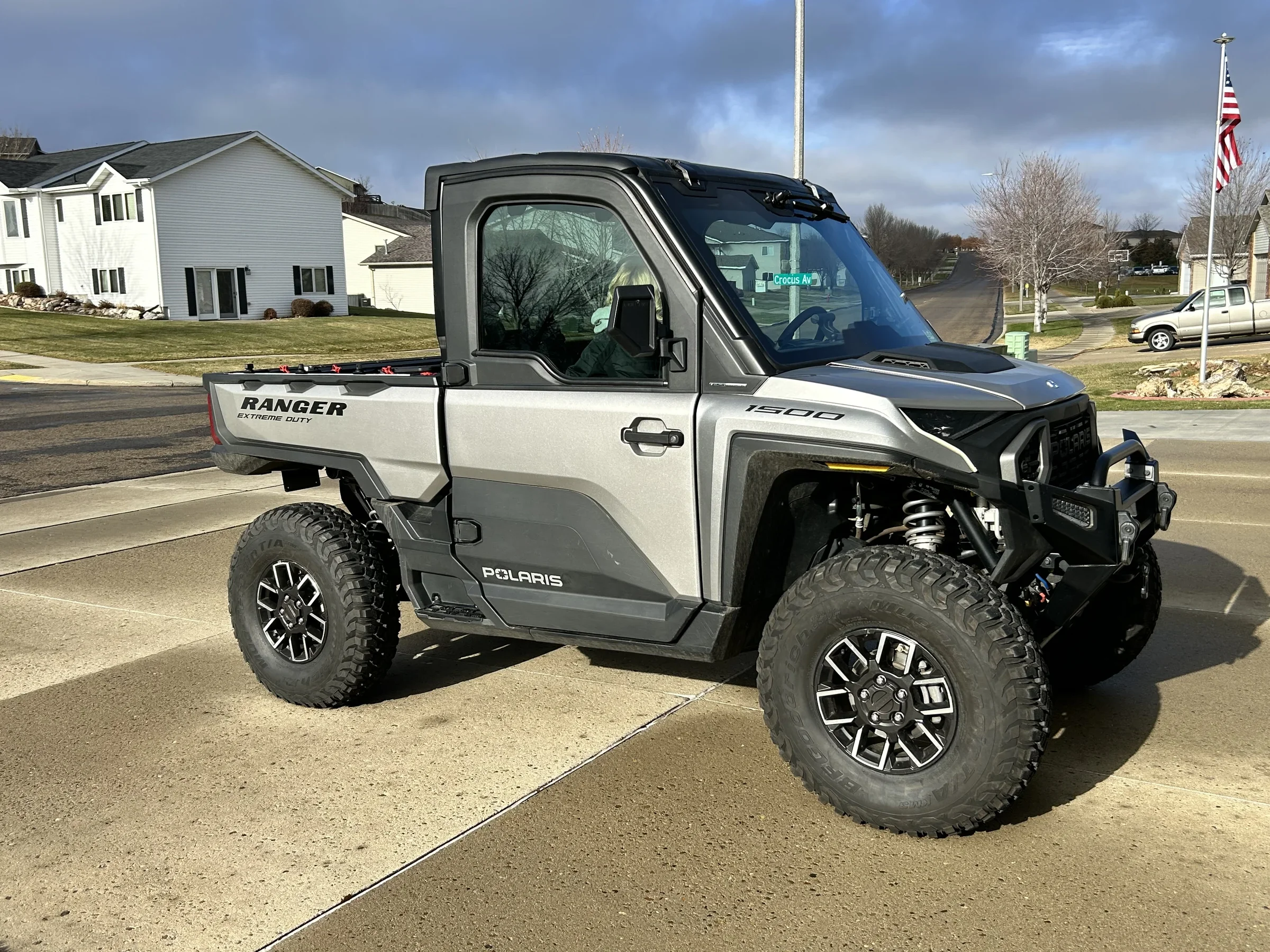

Yes you can do that on stock wheels. Unless I've lost my mind I believe ALL the wheels on the XD are 7" wide rims. The XP1000 uses 6" in the front and 8" in the rear but I'm sure the XD's are all 7". There are plenty of examples of people here running the same size tires on stock wheels.
Here is 1 picture from this site using stock wheels, many more if your search for them.
Ok thank you, those wheels look the same size? Is it just the back set/offset thats different? The front of the wheels look the same?
There are no differences in the wheel, all 4 are the same. The difference is only in the tires Polaris put on the wheels. They put 10" wide tires on the front and 11" wide tires on the rear. So, you should be good to put any 32"-33" tall X 10"-11.5" wide tire on them that you want to. 32" X 10" is by far the most common size that people put on the XD's
Oh heck yeah, no more searching for wheels new tires it is WOOHOO. Thanks for all the replies

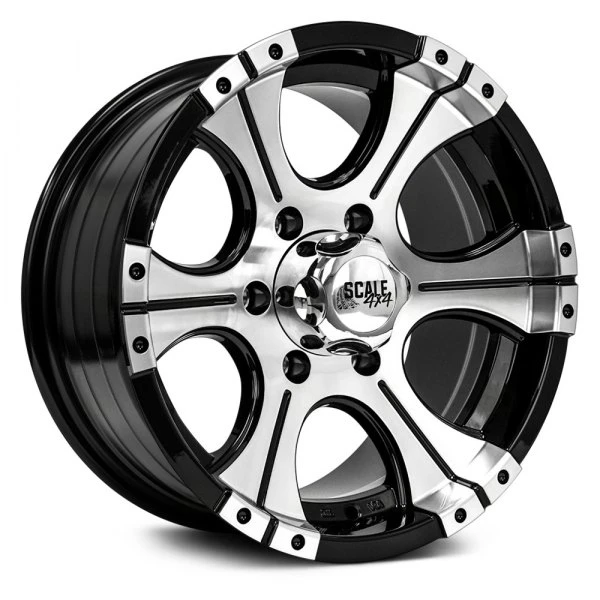

Hi, has any one run a 0 offset ? looking at these.
Wheel Offset: 0
Product Brand: Scale
Product Model: Ace
Wheel Width: 8
Wheel Size: 15
Wheel Bolt Pattern: 5x114.3
Center Bore: 83.06
