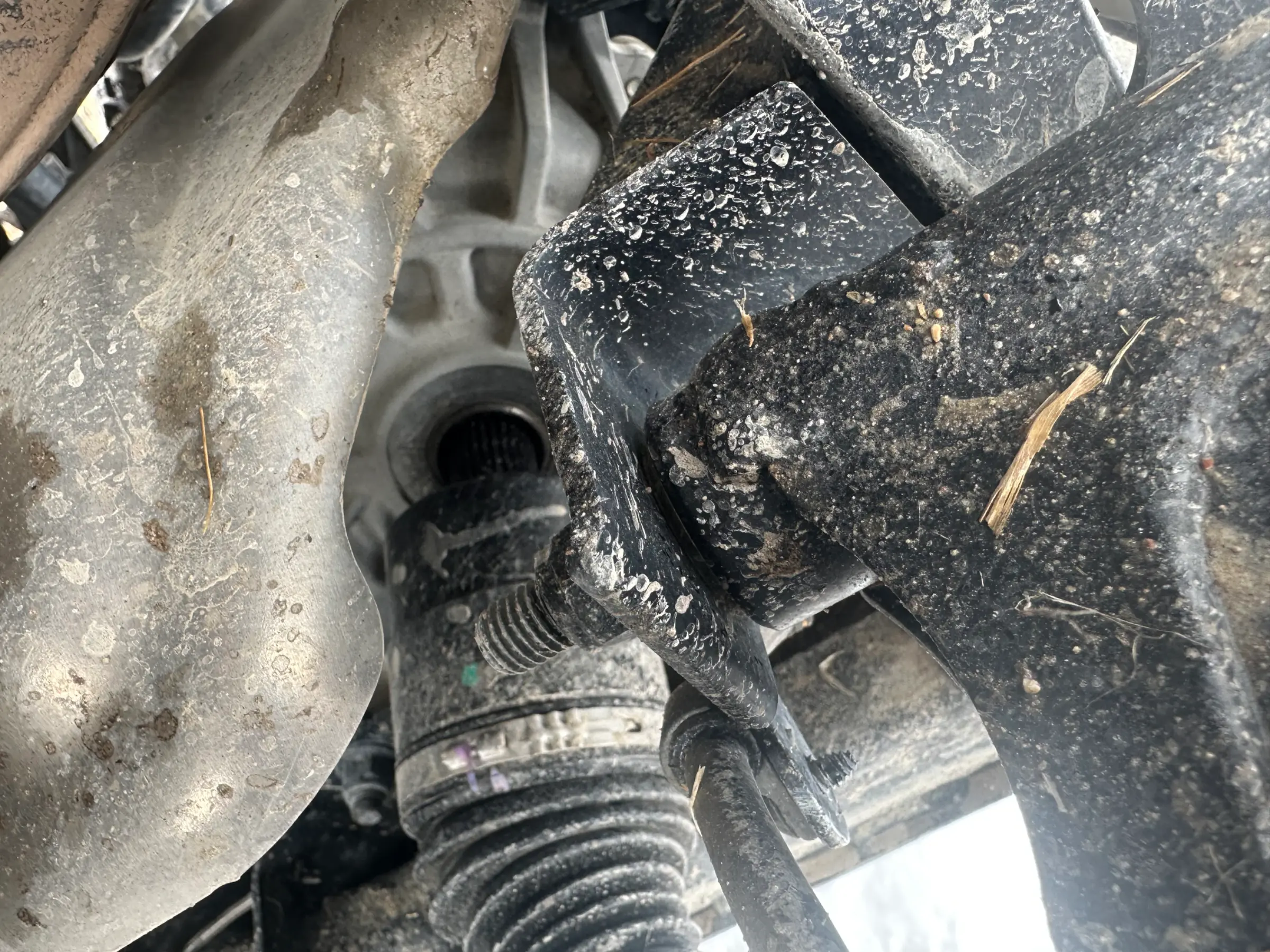

The way the axles are designed by length they can’t come completely out.
Mine looks like it's all the way out. this is with the suspension sitting on its own weight. If the suspension would drop, like after a hill or bump, it would even be worse.
Need to either spread or replace the circlip on the end of the axle. As Clubbin stated I don't believe it can come completely out without unbolting the bearing housing from the a-arms
You are 100% correct it can’t come out any more than that.
Yep. Again. Changed this axle last week. I opened up the inner clip good too. But it popped out. Always drivers side. Maybe 5 miles on this axle.

There is a rubber oring on the axles after the splines. You have to really hammer the axle in to get it to seat all the way because the oring puts pressure on it. I installed a new axle and thought it was seated two or three times then the last time I tore it apart I got the axle perfectly straight and hit it with a hammer and it fully seated and never popped out again.
Yes. That could be an issue some of us may encounter. The rear axles are good in a way that you can see from the rear if they are fully seated. Unfortunately this wasn’t my issue.

It is drivable, you would need to lock the rear diff. I would strongly discourage this though. Every time I’ve ever had an axle pop out I’ve been able to shove it back in after spitting out a few choice words.
