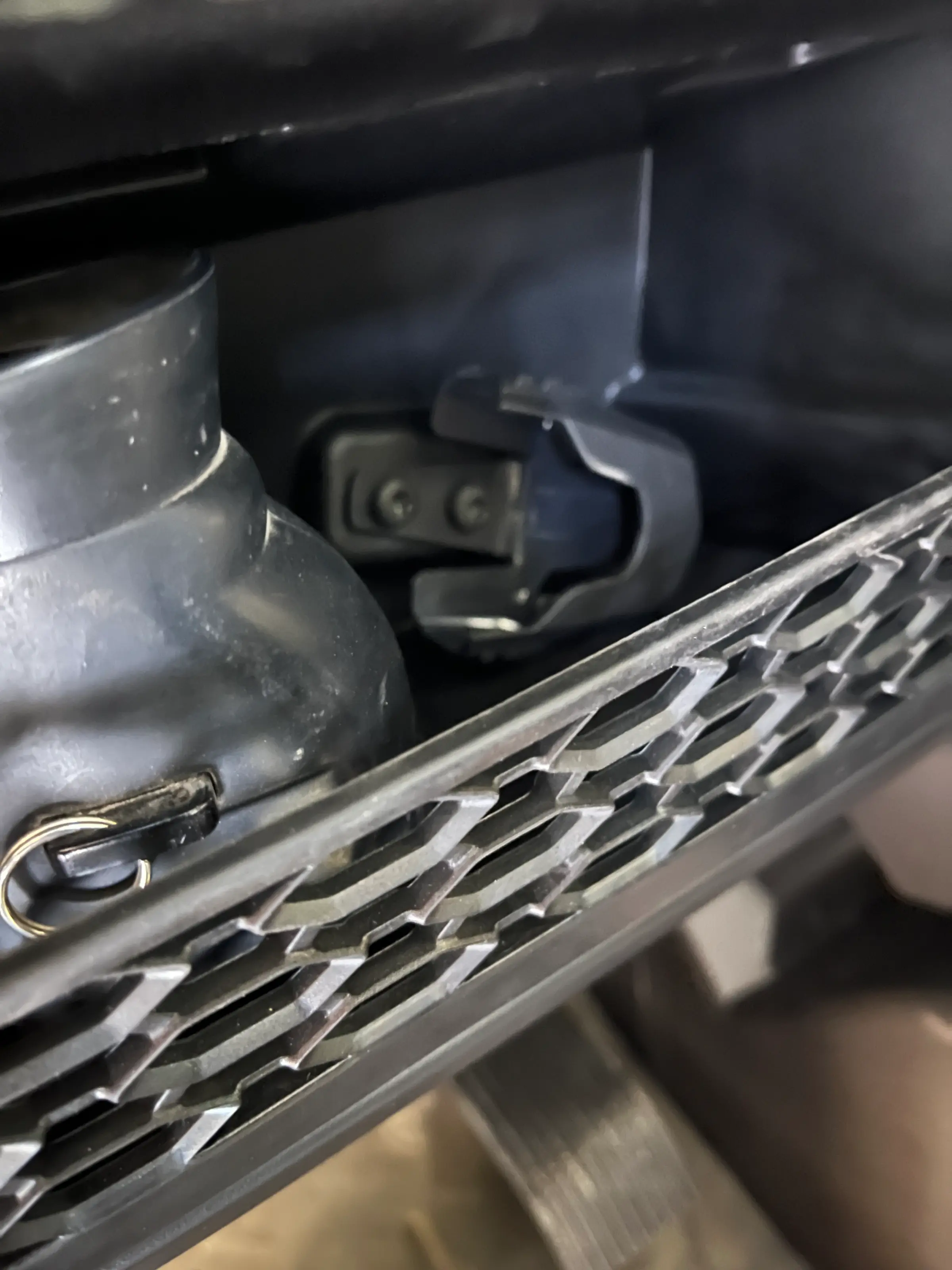

Here is pic of straps and winch remote holder.
